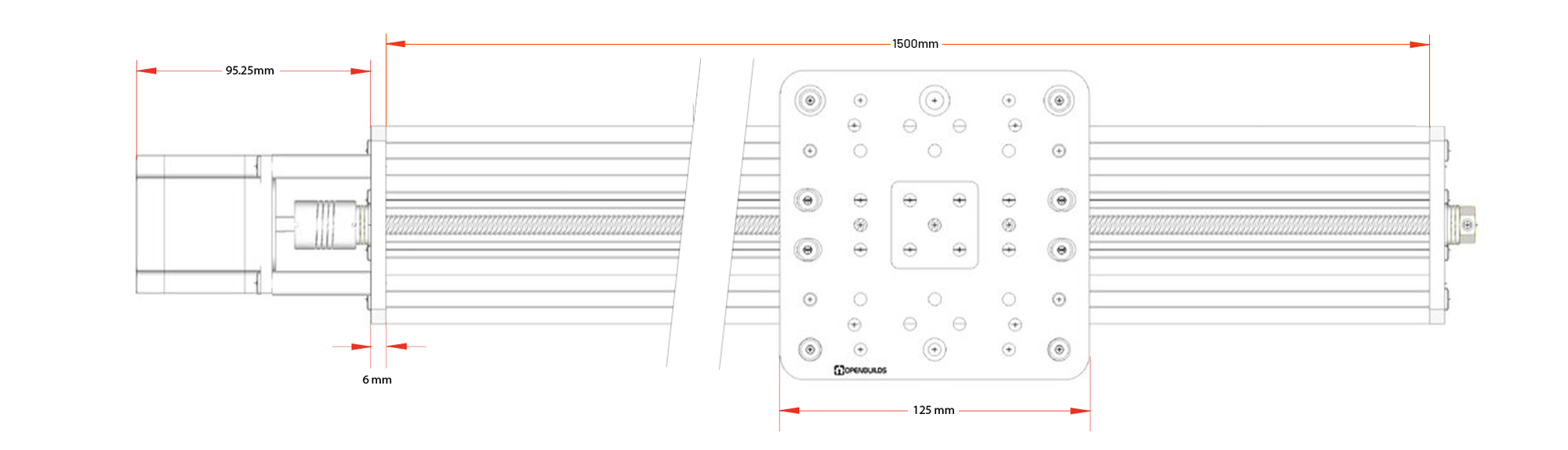

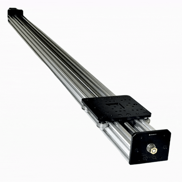

The C-Beam® Tension X-Long Linear Actuator earns its name from its ability to maintain exceptional precision and stability across extended spans while still incorporating a Lead Screw system.
Its tensioned design reduces flex, while four externally mounted Xtreme wheels offer increased support along the C-Beam Linear Rail. Engineered for smooth and consistent motion, this actuator is an excellent choice for managing loads that need to move long distances.
Key Features:
  • Long 1500mm Length
  • Lead Screw Driven
  • Adjustable Tension Nut
  • Dual Nut Blocks for Lead Screw Stability
  • Includes:
    • Complete Hardware Kit - Does not include NEMA 23 Stepper Motor
    Side-by-Side Image Popup
    C-Beam Tension XL Spec 1
    C-Beam Tension XL Spec 2
    Accuracy:0.05mm ~ 0.10mm
    Accuracy Positioning: 0.091mm
    Max Force: 26lbs
    Max Speed: 8000 mm/min
    Gantry Plate Size: 125 x 125mm
    Gantry Plate Thickness: 6mm (~1/4")
    Color: Clear Anodized Silver
    Travel:
    • 1500 mm Actuator - 1355 mm
