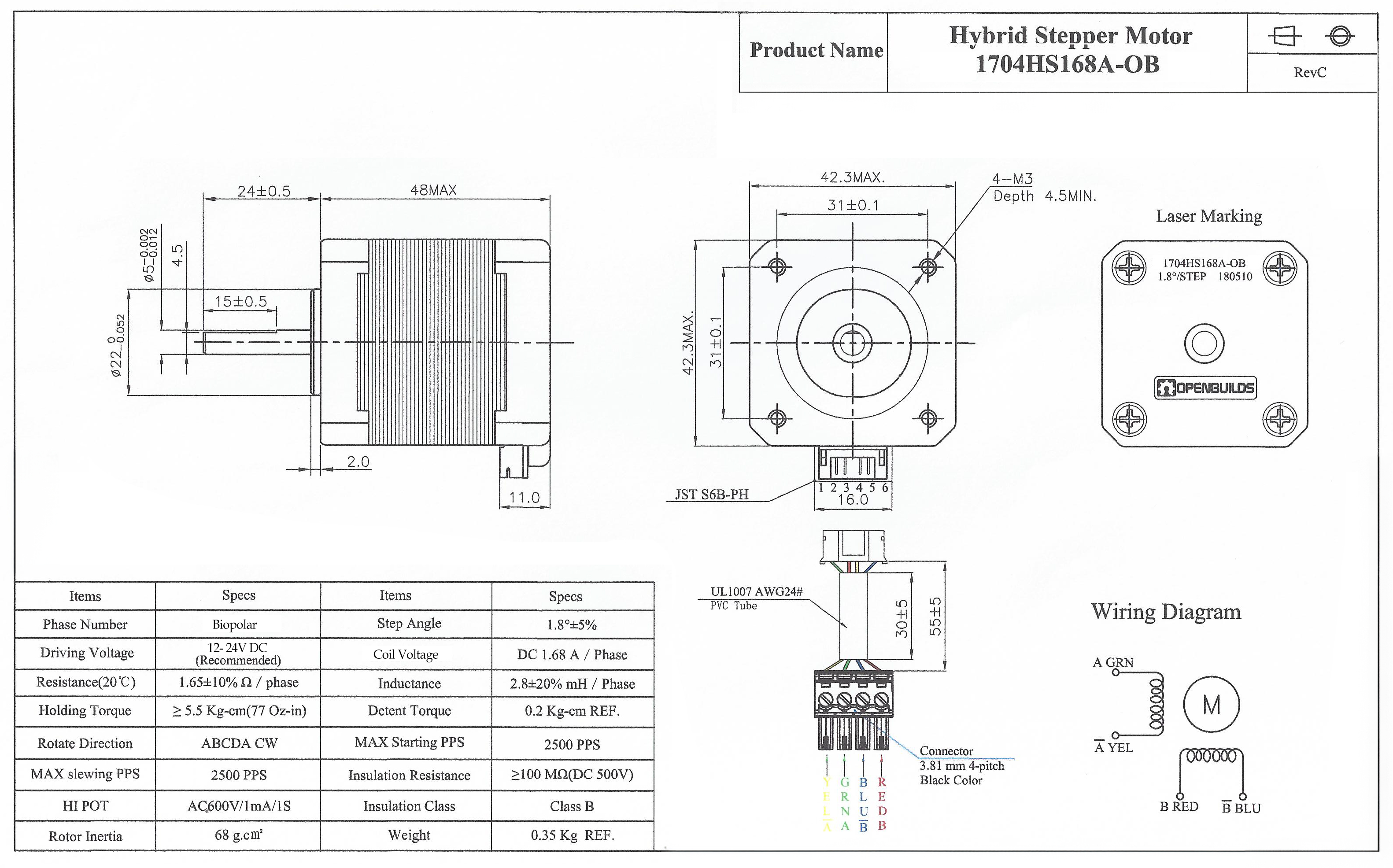

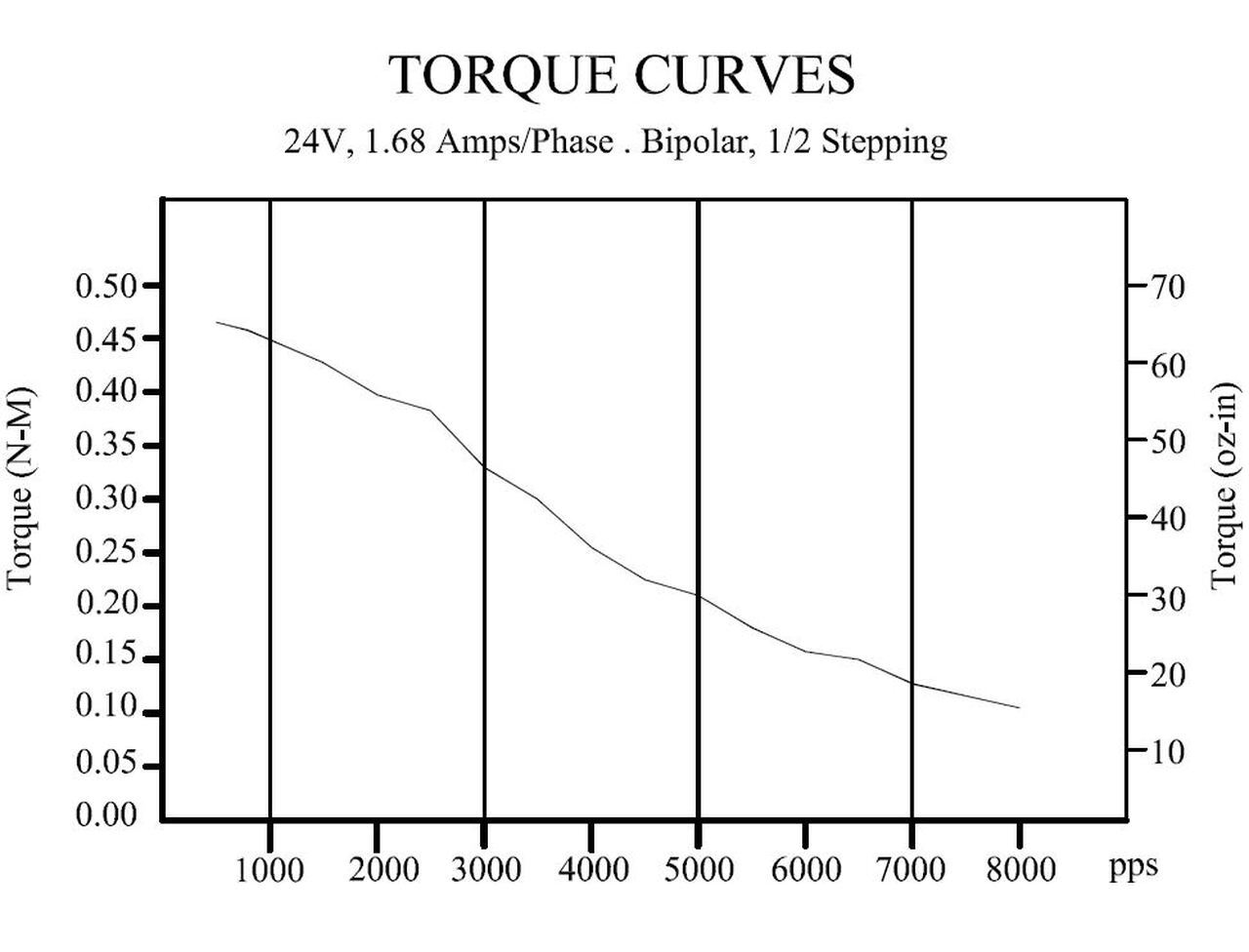

    NEMA 17 Stepper Motor Specifications:
  • Bipolar
  • Shaft Size: 5mm
  • Torque: 77 Oz*in
  • Inductance: 2.8 mH / Phase
  • Step Angle: 1.8°
  • Coil Voltage: 1.68 A / Phase
  • Wiring: 4-wire bipolar
  • Voltage Range: 12-24V DC (Recommended)
  • RoHS Compliant
