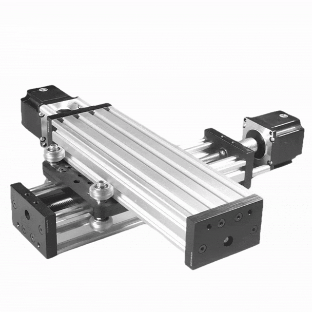

The C-Beam® XLarge X/Y Table is a stable platform designed for precise movement along two axes. It's a great choice for CNC routing, 3D printing, laser engraving, and other automated tasks that require accurate and repeatable motion.
Built using rigid XL Gantry Plates joined together, this setup offers strength and reliability across a wide range of applications.
Key Features:
  • Lead Screw Driven
  • Stable platform for 2 Axes operations
  • Includes:
    • Complete Hardware Kit - Does not include the (2) NEMA 23 Stepper Motor
    • Mounting Hardware
    Side-by-Side Image Popup

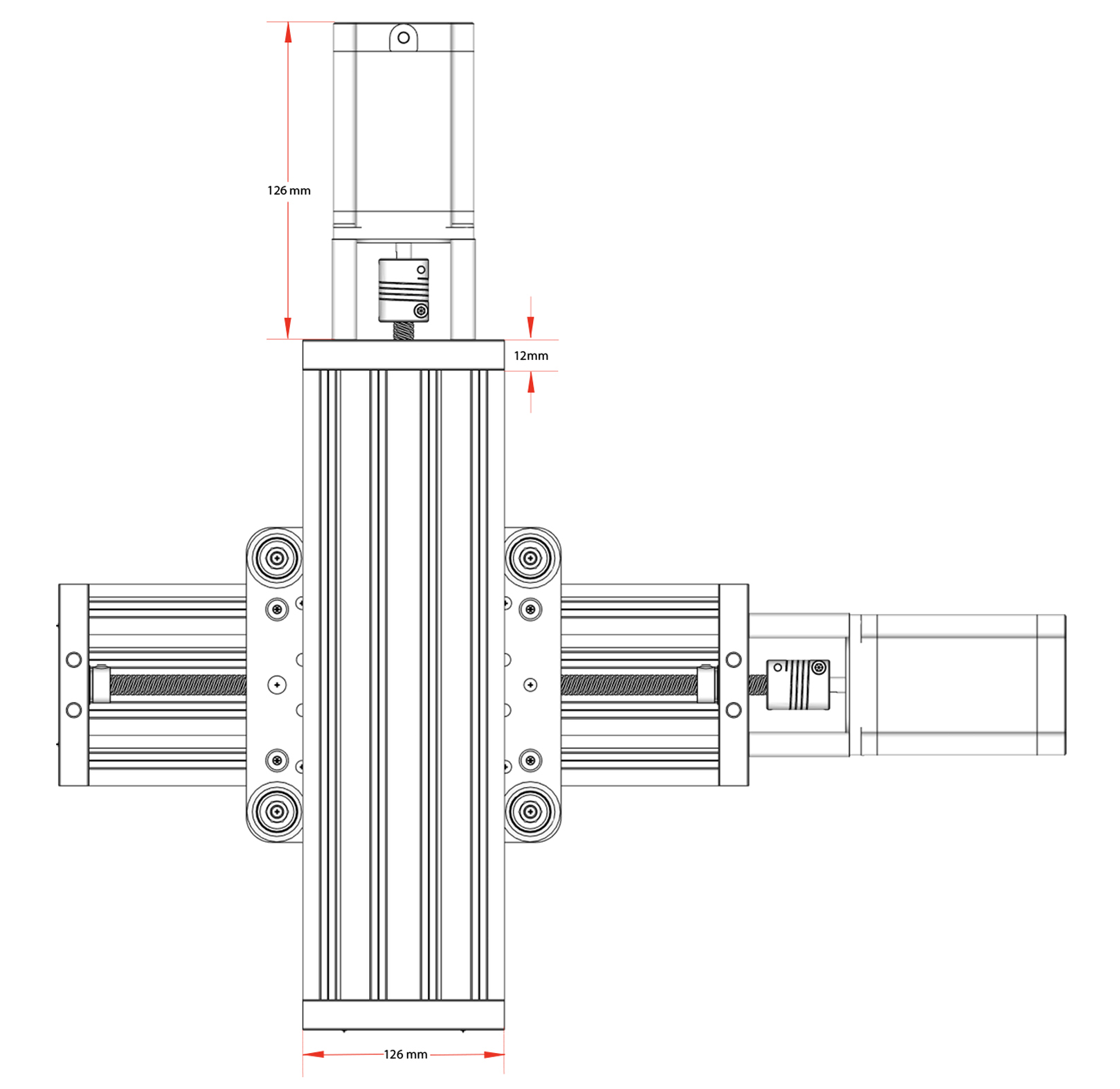

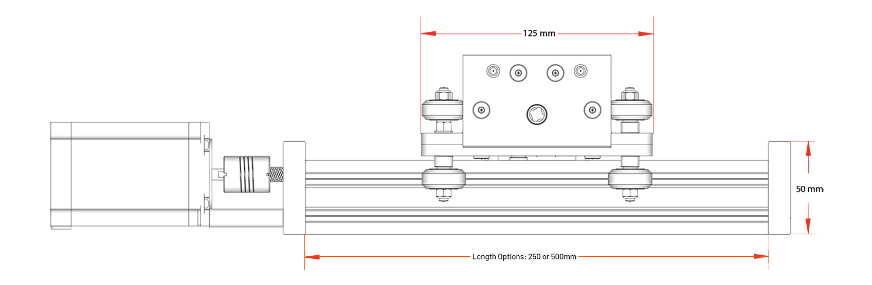

    C-Beam XLarge Table Spec 1
    C-Beam XLarge Table Spec 2
    Accuracy:0.001" ~ 0.003" (0.05mm ~ 0.10mm)
    Accuracy Positioning: 0.091mm
    Max Force: 26lb (115N)
    Max Speed: 8000 mm/min
    Color: Clear Anodized Silver
    Travel:
    • 250mm Actuator - 115mm travel
    • 500mm Actuator - 365mm travel
    • 1000mm Actuator - 885mm travel
